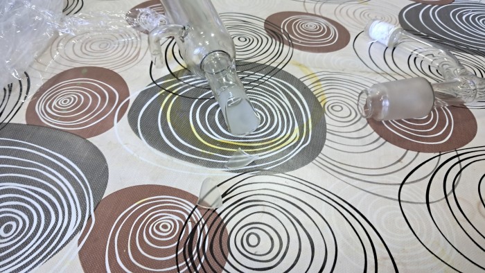

Repair of Condenser for Distillation in Unsuitable Conditions
http://chemistry-chemists.com/N3_2025/C ... -P2-1.html
