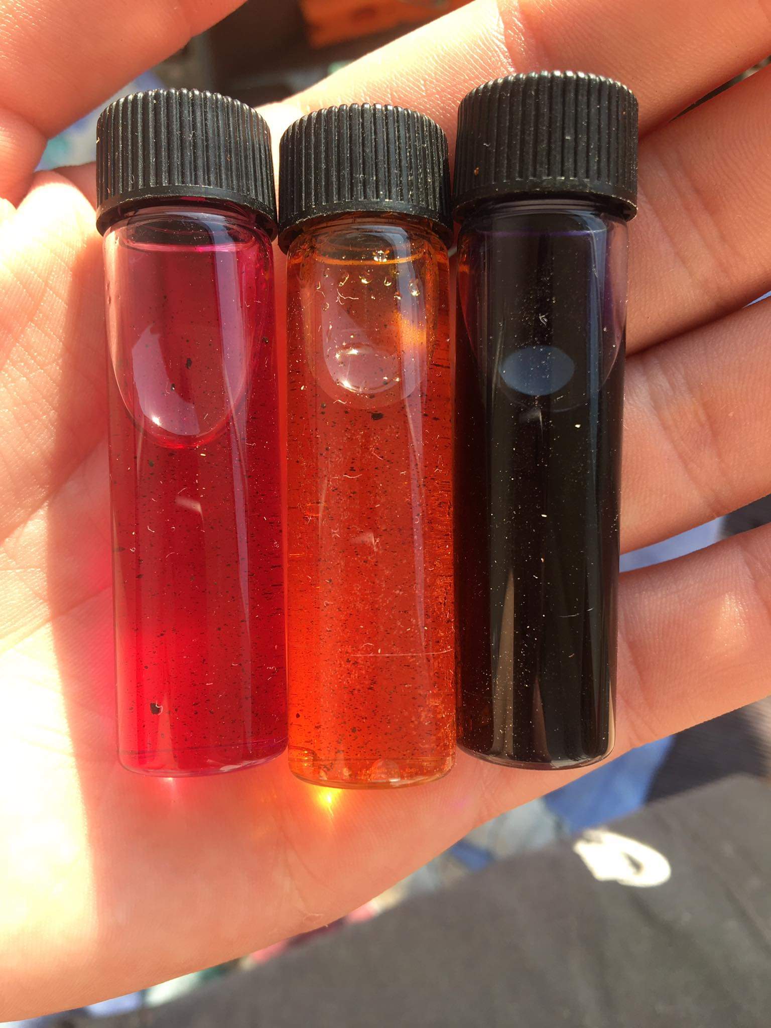

Hi. I found old very small jar without label, i know that it is indicator from "реахим", its in typical brown jar as many "реахим" chemicals. It has dark green, almost black colour.
On photo: acidic, neutral and basic.

Looks same, but is litmus in basic solution opaque?

PostPosted: 01 Sep 2021 20:36
Posts: 69131
Is the left solution acidic and the right solution is basic? Left is red, right is black?
PostPosted: 01 Sep 2021 20:39
Joined: 14 Jul 2021 12:13
Posts: 333
Location: Georgia
Yes Volodymyr red is acidic and dark violet is basic.

PostPosted: 01 Sep 2021 20:49
Posts: 69131
In basic solution litmus is blue. It is not litmus.
I do not know any indicators with such a transition (red - purple). Maybe it's a mixture?

Strange. I diluted this dark violet solution three times (pour half and add same volume water) but nothing happened still opaque. I don't know it's mixture or not, i never seen mixture analytical reagent of this company.

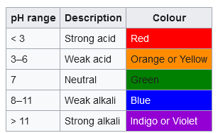

PostPosted: 01 Sep 2021 21:10
Posts: 69131
For example, Universal indicator https://en.wikipedia.org/wiki/Universal_indicator
___________
Try: a few drops of the dark solution in a glass of distilled water.
PostPosted: 01 Sep 2021 21:19
Posts: 333
Location: Georgia
I think you are right, i used tap water and maybe it was little bit acidic, that is why solution in middle vial has orange colour. Thank Volodymyr! I will try
