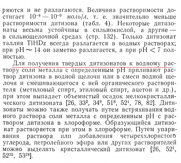

Hello. How to make Dithizone-transition metal complexes? i know its analytical reagent, but i want solid form of this complexes.
PostPosted: 14 Dec 2021 16:16
Posts: 69131
Иванчев Г. Дитизон и его применение (1961). P.39 viewtopic.php?p=186421#p186421
