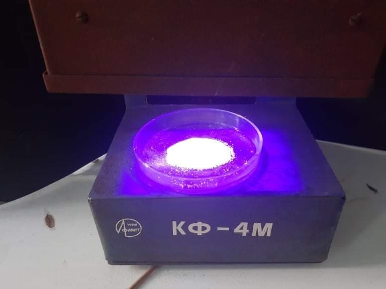

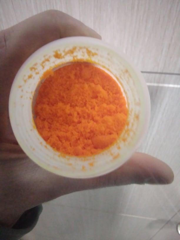

hello. can ayone explain how he made different colors?
https://www.youtube.com/watch?v=SyNzZdh ... LL&index=9
I tryed different ways but anytime powder had same colour.
This one i made from boric acid, eosin y, malonic acid and succinic acid. I also used different organic acids but nothing happened.
PostPosted: 07 Jan 2022 16:05
Posts: 69131
1. Try:
fluorescein
eosin
rhodamine
2. Boric acid must be pure. Try to heat (same conditions) boric acid without activator. Boric acid with impurities will glow.
http://chemistry-chemists.com/N1_2017/C ... -P3-1.html
PostPosted: 07 Jan 2022 16:23
Joined: 14 Jul 2021 12:13
Posts: 333
Location: Georgia
thanks! your way is much easier. i used lab grade boric acid, it was pure as i know. i will try thanks again. also how to make for example red and more colours?
PostPosted: 07 Jan 2022 18:46
Posts: 69131
I did:
fluorescein (H3BO3) - green
salicylic acid (H3BO3) - blue
fluorescein (sugar) - green
eosin (sugar) - yellow
rhodamine (sugar) - red

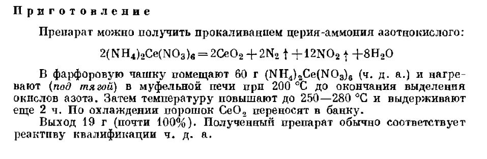

hello! what is the easiest way to make cerium dioxide from Ammonium cerium(IV) nitrate?
PostPosted: 17 Jan 2022 13:04
Joined: 18 Sep 2015 22:09
Posts: 124
You can thermally decompose it. To do this you need to heat it up in a fume hood! to 200 C, while NO2 will not stop releasing(carefully, very toxic gas), then raise the temperature to 250-280 degrees and calcine for another 2 hours.

PostPosted: 17 Jan 2022 13:08
Posts: 333
Location: Georgia
thank you so much!

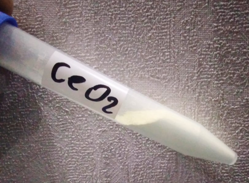

PostPosted: 18 Jan 2022 20:41
Posts: 333
Location: Georgia
very easy. thaks again!
