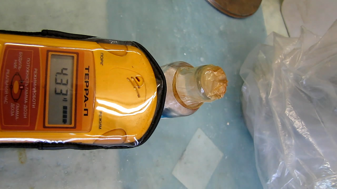

I know that uranium is not a rare element in nature. if anyone has the experience, is it easy to find uranium ores? I don't mean areas near a uranium mines.
PostPosted: 07 Aug 2022 21:21
Posts: 69131
Samples of uranium minerals have significant activity. Household dosimeters easily detect it.

thank you! just i have no idea if there are uranium ores in Georgia.
what do you think can it determine uranium ore? maybe it's real.
https://www.youtube.com/watch?v=rIDNUoV ... rTeslonian
PostPosted: 08 Aug 2022 10:29
Posts: 69131
For determining of uranium any device for determining of ionizing radiation (gamma-, alpha-) will do.
Where there can be uranium minerals in your country, I do not know.
