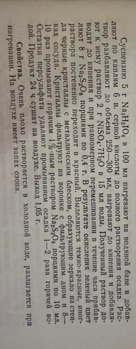

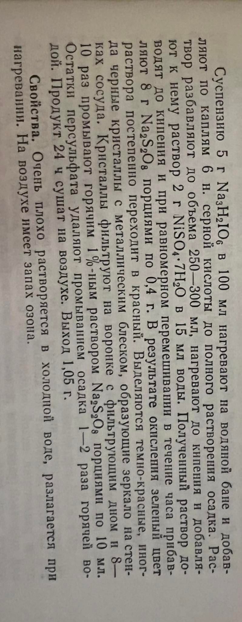

why one hour of stirring is necessary?
302333929_800428334560791_4378655204167826758_n.jpg [ 214.96 KiB | Viewed 10016 times ]
PostPosted: 11 Sep 2022 09:32
Probably, the slow addition of Na2S2O8 is needed.

yes maybe, I added it in portions but nothing happened, then I add exec persulfate, and left it a night but still a clear green solution.
PostPosted: 11 Sep 2022 12:50
Posts: 69131
Persulfate may decompose during storage
PostPosted: 11 Sep 2022 13:15
Joined: 14 Jul 2021 12:13
Posts: 333
Location: Georgia
yes, you are right, but I made Cu(III) with the same persulfate month ago, I post it here as I remember this periodate complex.
ill try this reaction at second time when i go to lab.

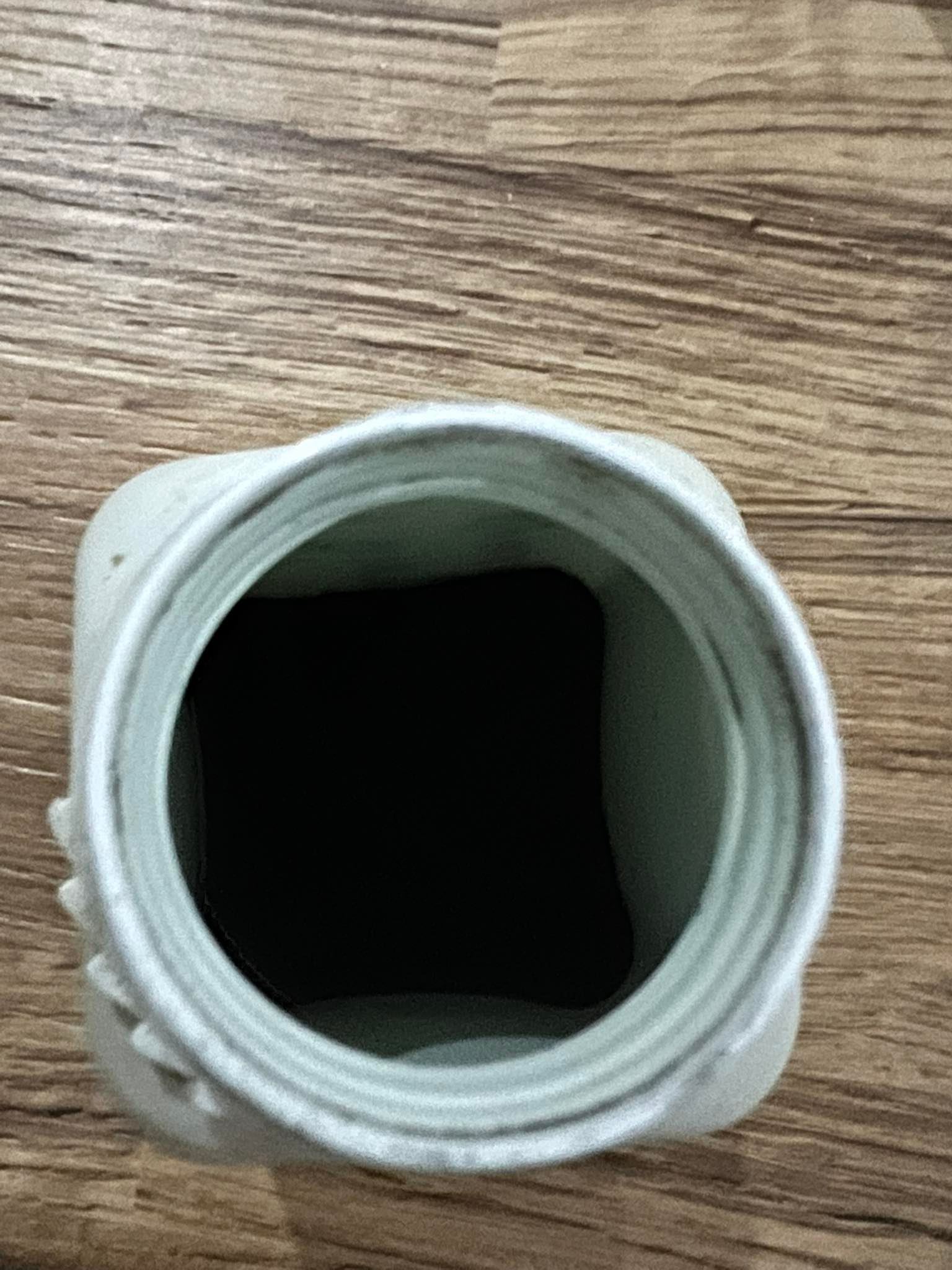

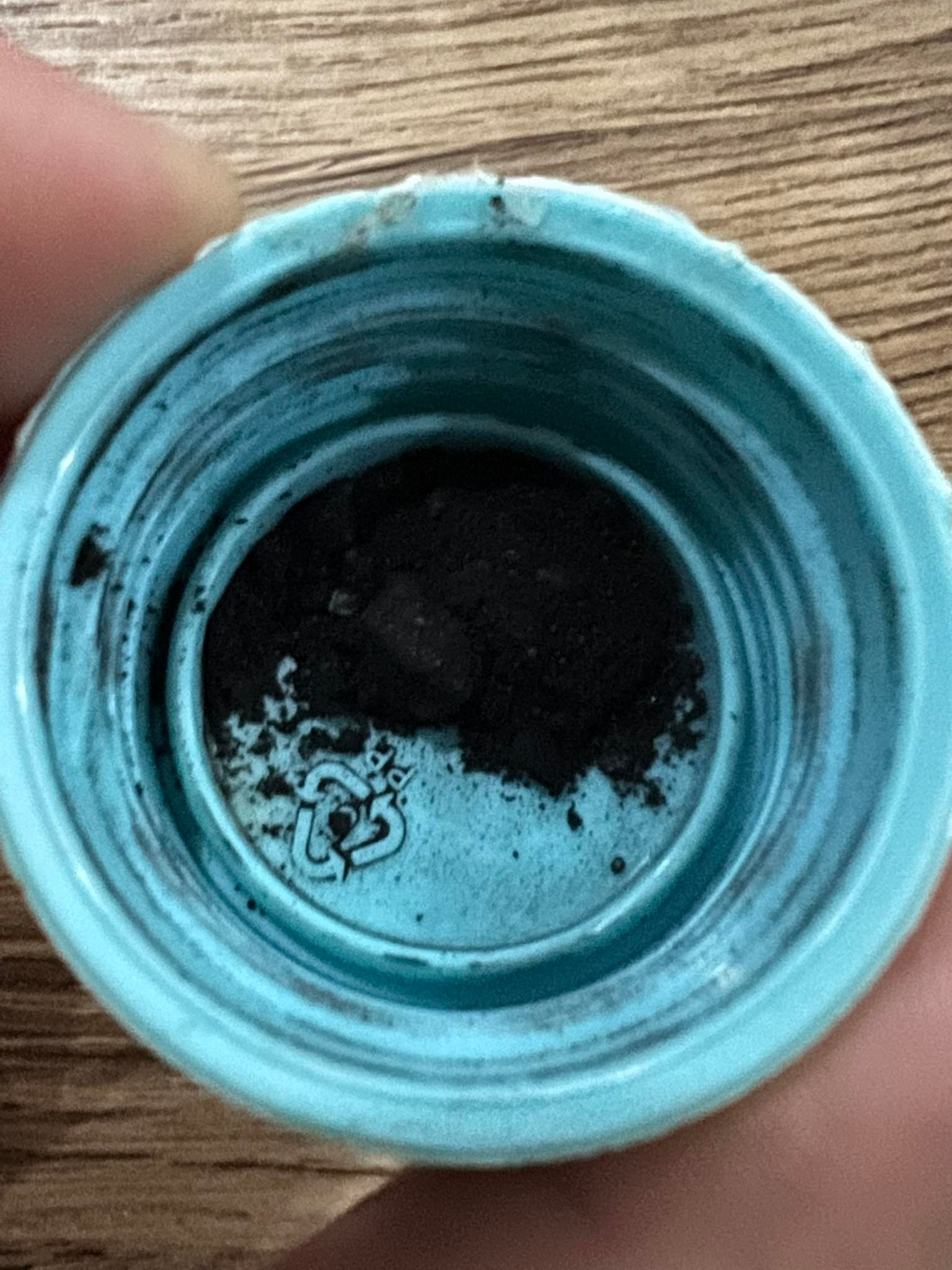

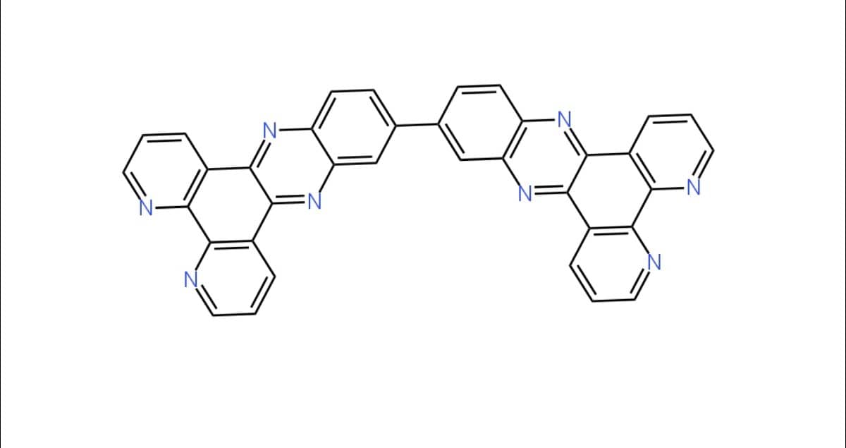

Hello, I had a jar of 3,3'-Diaminobenzidine, when I opened it it had black color and ammonia smell, what is the easiest way to make some pure 3,3'-Diaminobenzidine? just the reagent every photo which I saw on the internet had no black color. also, reagent is not soviet made, it's a fluka chemika reagent maybe 10-15 years old.
305187895_487703432877747_6680374237762542801_n.jpg [ 316.41 KiB | Viewed 9928 times ]
305563337_862964094692589_3424013765226170108_n.jpg [ 349.59 KiB | Viewed 9928 times ]
PostPosted: 13 Sep 2022 14:25
Posts: 69131
Benzidine and its derivatives are easily oxidized in air. The process is irreversible. I think, that in addition to oxidation, condensation reactions take place.

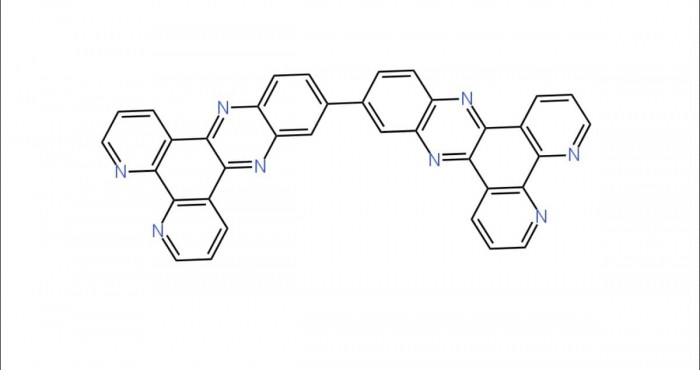

thank you! I opened it months ago. so I hope only a small amount is oxidized. so I thought if I recrystallized or something, I want to make an organic product(on photo) from this compound and 1,10-phenanthroline-5,6-dione, and finally, I want binuclear ligand, then ill make europium complex. finally molecular will be like that two europium metals, one this compound and six any acetylacetone derivative.
the ligand which i made in program:
PostPosted: 13 Sep 2022 15:40
Posts: 69131
Theoretically, recrystallization is possible. But I have not heard that oxidized benzidine being purified in this way. Amino derivatives are oxidized even more easily than benzidine itself.

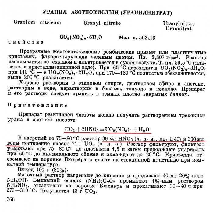

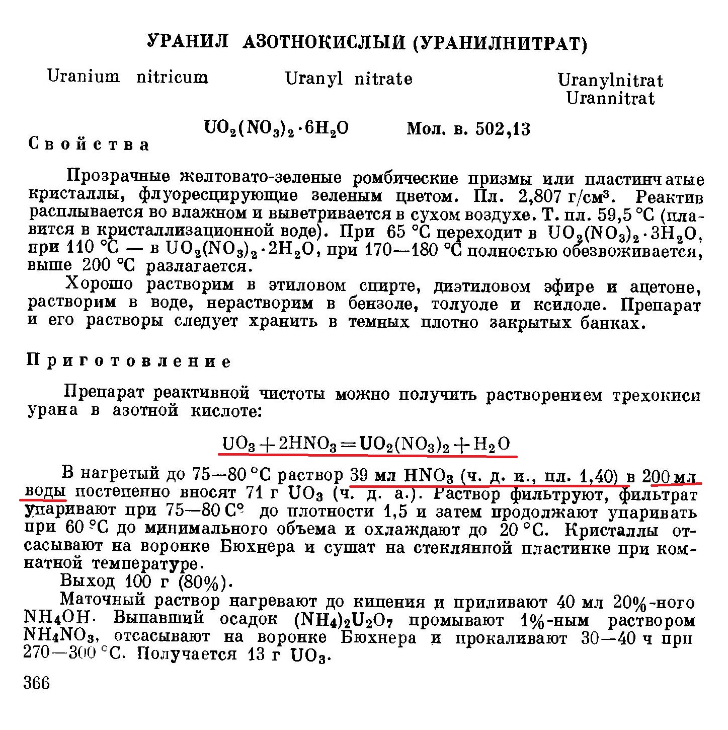

what is the best way to make uranyl nitrate from metallic uranium? I just want a few ml of its solution to make heteropolymetalate, I don't want it as solid salt.
PostPosted: 16 Sep 2022 13:41
Posts: 69131
The compound is synthesized from UO3 and dilute HNO3. Metallic uranium is a less available raw material, but it can also be used.
File comment: Ю.В. Карякин, И.И. Ангелов Чистые химические вещества
viewtopic.php?f=15&t=35&p=1750#p1750
PostPosted: 16 Sep 2022 13:49
Posts: 333
Location: Georgia
thank you! I saw the oxide method, but I don't have it. I think nitric acid cant oxidize uranium to (VI), maybe it will produce uranium(IV). I can oxidize (IV) to (VI) with H2O2, but I don't know which tetravalent compound will form. there is no uranium nitrate yes? only uranyl nitrate. maybe it produces UO2?
