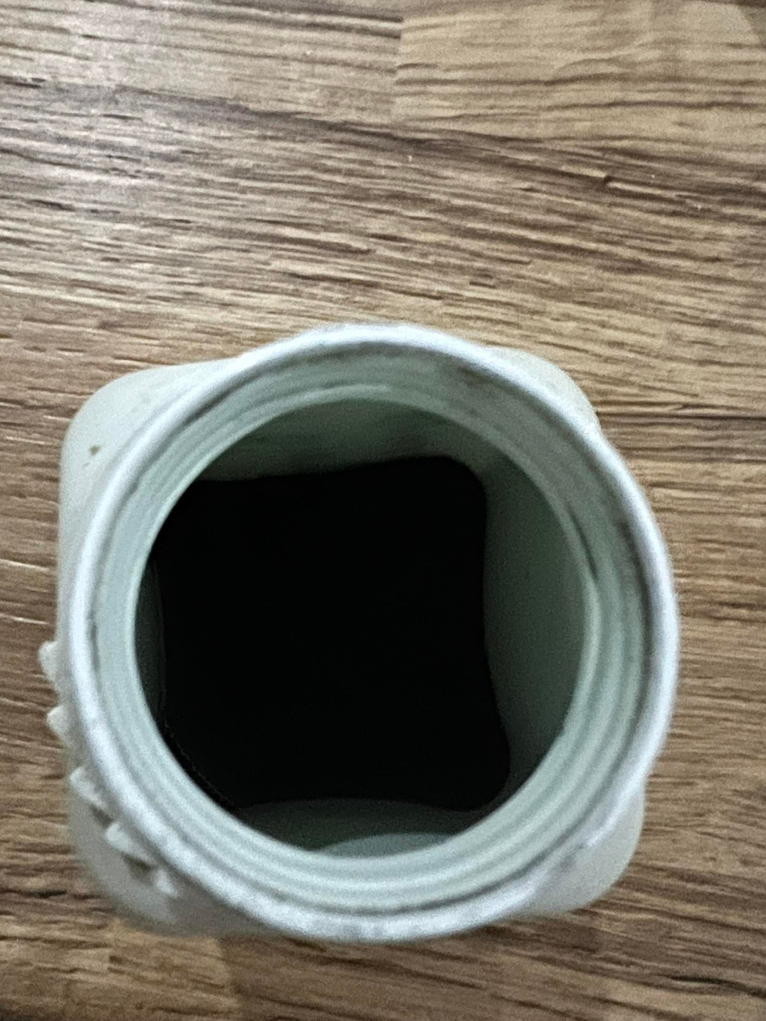

Hello, I had a jar of 3,3'-Diaminobenzidine, when I opened it it had black color and ammonia smell, what is the easiest way to make some pure 3,3'-Diaminobenzidine? just the reagent every photo which I saw on the internet had no black color. also, reagent is not soviet made, it's a fluka chemika reagent maybe 10-15 years old.

PostPosted: 13 Sep 2022 14:25
Posts: 69131
Benzidine and its derivatives are easily oxidized in air. The process is irreversible. I think, that in addition to oxidation, condensation reactions take place.

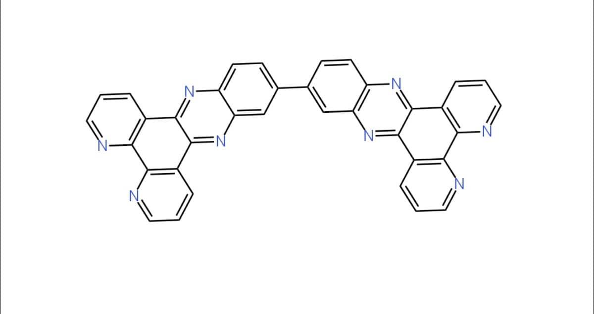

thank you! I opened it months ago. so I hope only a small amount is oxidized. so I thought if I recrystallized or something, I want to make an organic product(on photo) from this compound and 1,10-phenanthroline-5,6-dione, and finally, I want binuclear ligand, then ill make europium complex. finally molecular will be like that two europium metals, one this compound and six any acetylacetone derivative.
the ligand which i made in program:

PostPosted: 13 Sep 2022 15:40
Posts: 69131
Theoretically, recrystallization is possible. But I have not heard that oxidized benzidine being purified in this way. Amino derivatives are oxidized even more easily than benzidine itself.
