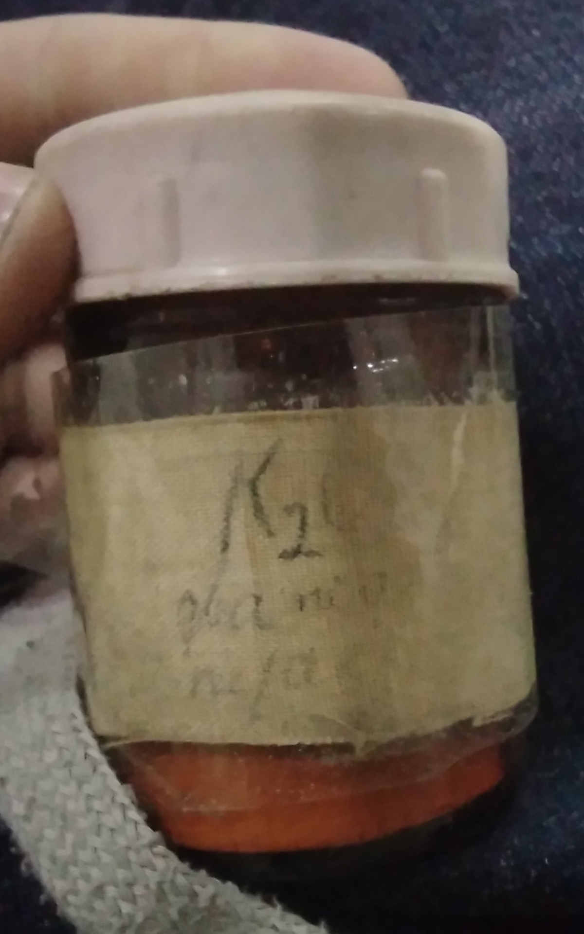

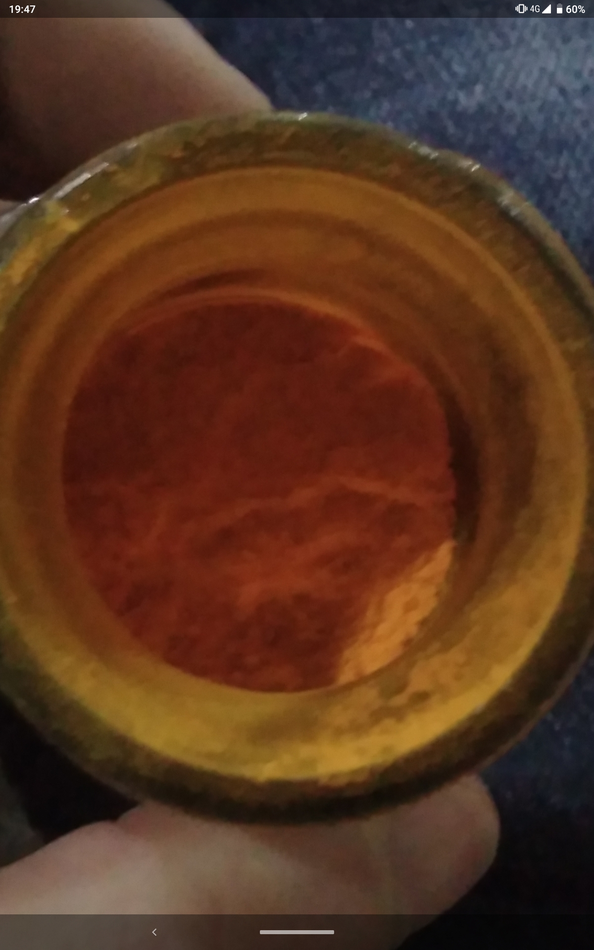

Does anyone know what is this orange chemical? I can't read.
PostPosted: 12 Nov 2021 19:15
Posts: 69131
K2Cr2O7?
PostPosted: 12 Nov 2021 23:35
K2Cr2O7?
It is hard to say. The photo is blurry. Under the formula fragment, the word in Latin looks like "kalium" (potassium). And аt the bottom of the label it looks like a fragment of the word in Russian "перекристаллизованный" (recrystallized).

thanks for answers. it's dichromate.
i also found one small jar. im sure its organic compound, label was wet, so i lost it When I took it out of the bag. i remember that first i thought on the label there is written barium. im sure its starts with "Ва", it is a small word like Валин, And as i remember in the middle of the word were two identical letters.
For two days I have been trying to recall what was written but to no avail, maybe those who know the language can easily understand the name of this organic compound.
EDIT: i forgot it has white colour.

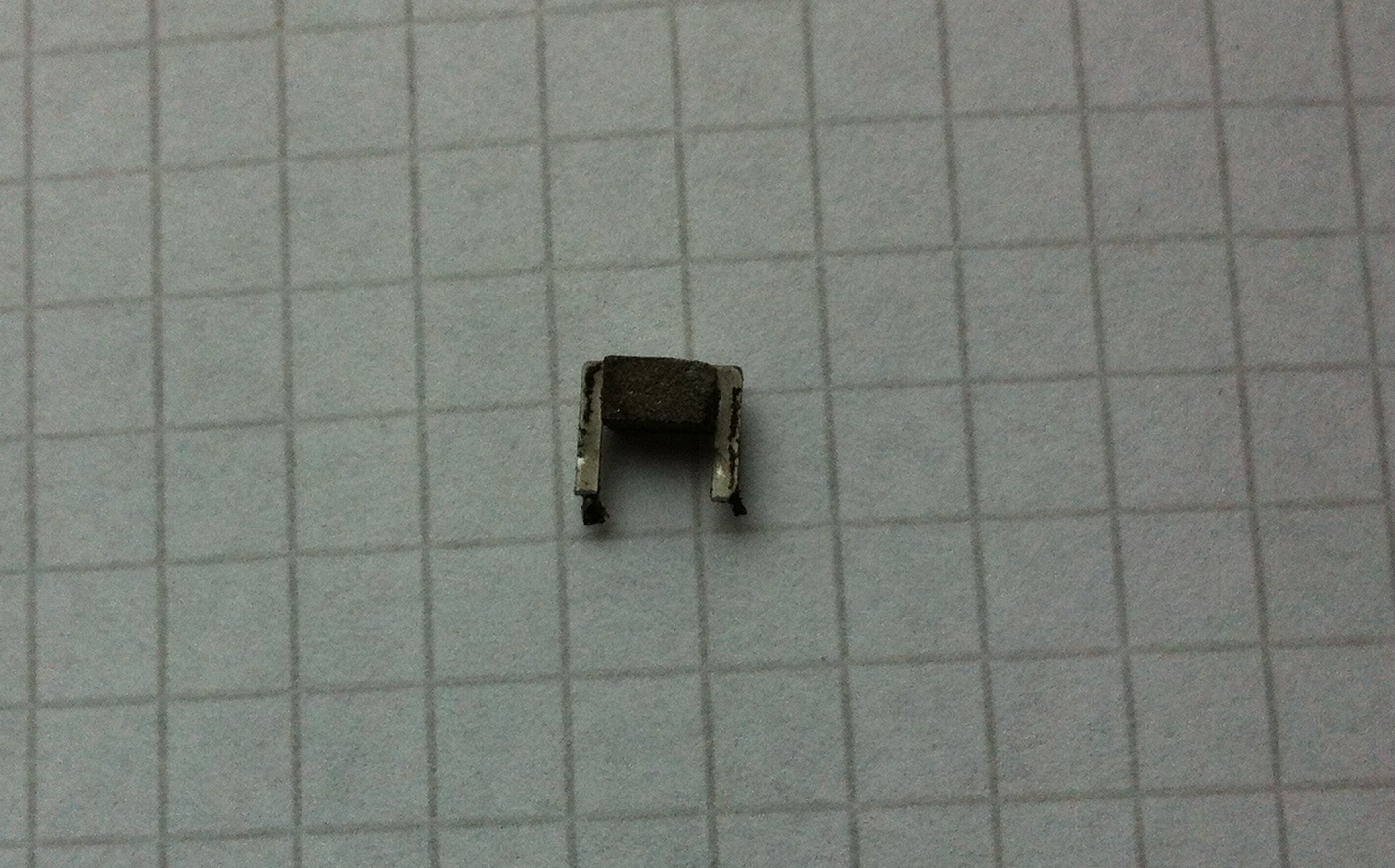

Есть такой геттер с радиолампы. Может у кого есть мысли из какого металла он может быть.
Добыл из электрометрического триода ЭМ-7 этот геттер.
На наждаке дает белые искры. Но довольно мягкий если точить на напильнике, титановоя таблетка с индикатора ИН-12 намного тверже.
В голову приходит или лантан, церий или геттер на основе циркония марок ST.
