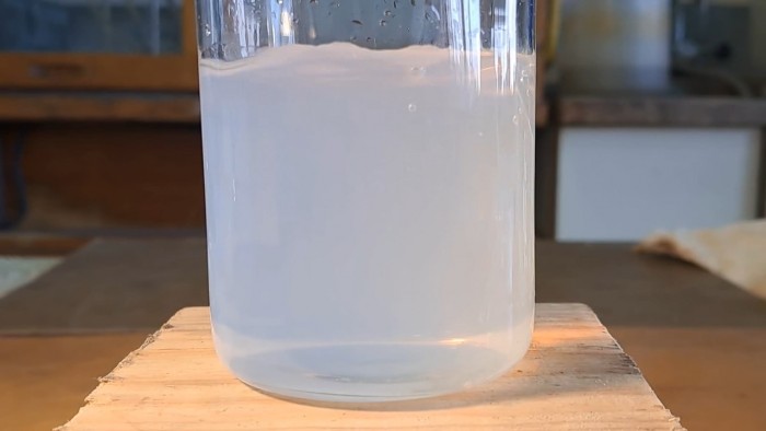

Reaction of Sodium Carbonate with Sodium Chloride
http://chemistry-chemists.com/N3_2025/C ... -P3-1.html
Reaction_of_Sodium_Carbonate_with_Sodium_Chloride-7.jpg [ 277.17 KiB | Viewed 570 times ]
