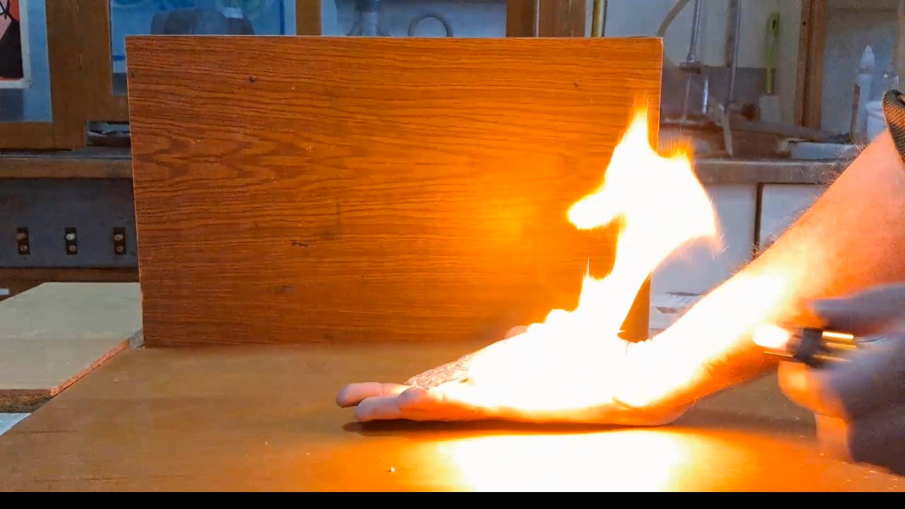

Fire on Hand (Combustion of Nitrocellulose Film) - Part 10
http://chemistry-chemists.com/N2_2025/C ... -P1-5.html
