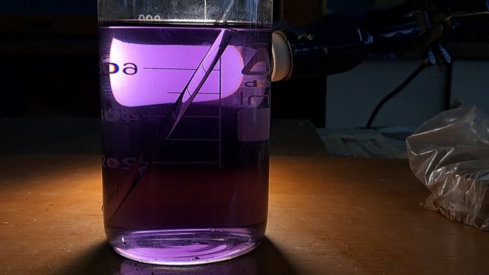

Posts: 65872
Phenol-Iron Complex and Sodium Hydroxide - Part 5
http://chemistry-chemists.com/N3_2025/C ... .html#1002
