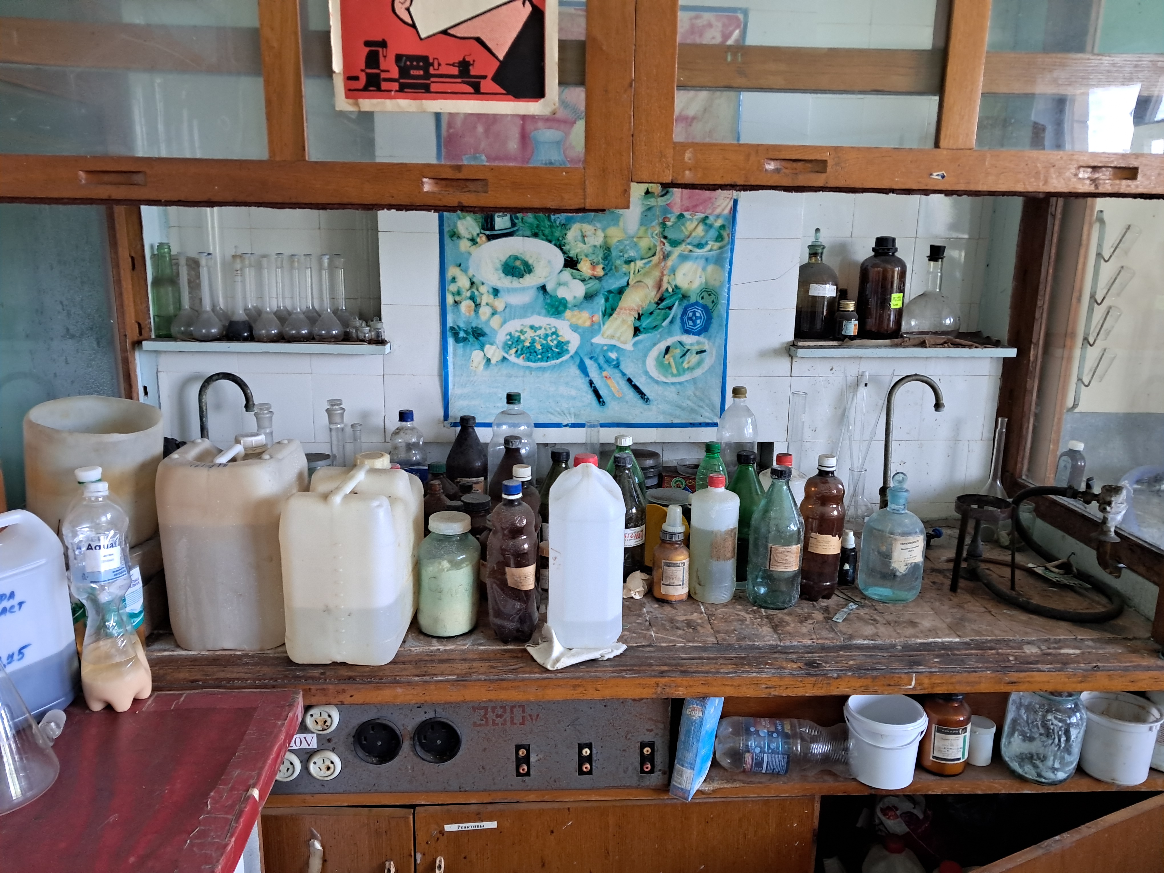

Determining Moisture Content in Hexamine
Problem Statement. What are the Methods for Determining Moisture? - Part 1
http://chemistry-chemists.com/N2_2026/C ... -P5-1.html
