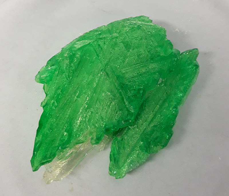

Оксалат калия и железа (III). Potassium ferrioxalate K3[Fe(C2O4)3]·3H2O
Ферриоксалатный анион [Fe(C2O4)3]3− довольно стабилен в темноте, но разлагается под действием света и электромагнитного излучения с более высокой энергией. Эта функция используется для химической актинометрии - измерения светового потока и для копирования чертежей.
The ferrioxalate anion is quite stable in the dark, but is decomposed by light and higher-energy electromagnetic radiation. This feature is exploited for chemical actinometry, the measure of light flux, and for the preparation of blueprints.
The complex can be synthesized by the reaction between iron(III) sulfate, barium oxalate and potassium oxalate:
Fe2(SO4)3 + 3BaC2O4 + 3K2C2O4 → 2K3[Fe(C2O4)3] + 3BaSO4
The reactants are combined in water, the solid precipitate of BaSO4 is removed, and the green trihydrate crystallizes from the cooled solution.
Another common synthesis is reacting aqueous iron(III) chloride hexahydrate and potassium oxalate monohydrate.
FeCl3 + 3K2C2O4 → K3[Fe(C2O4)3] + 3 KCl
