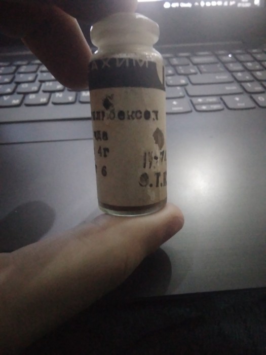

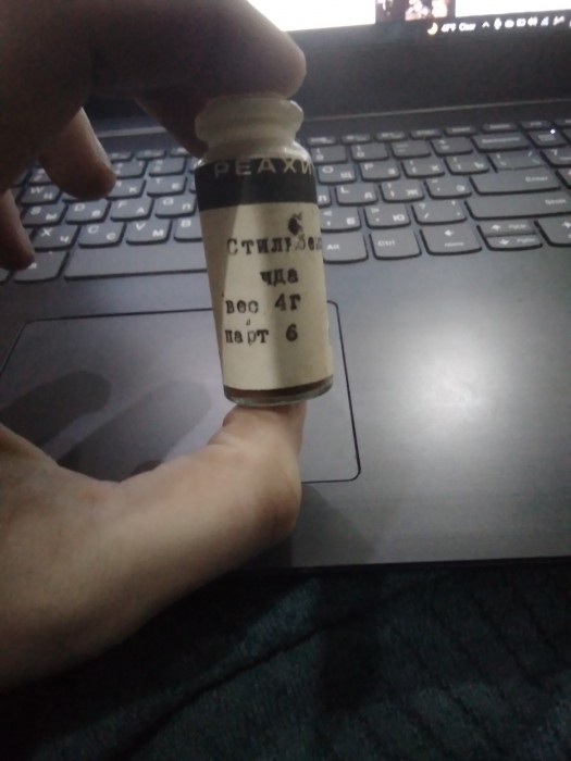

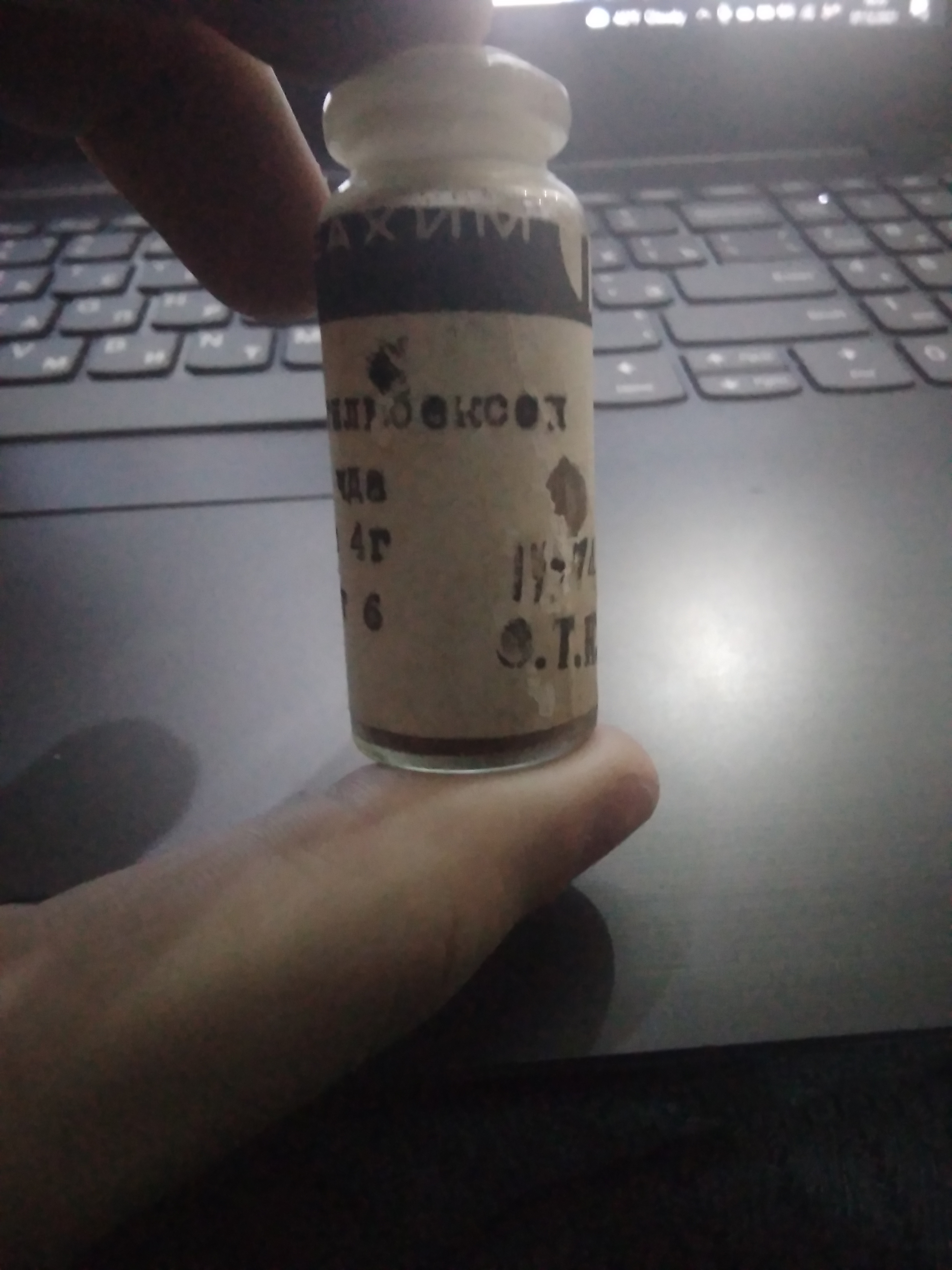

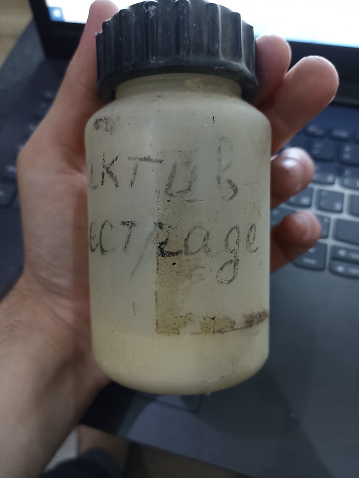

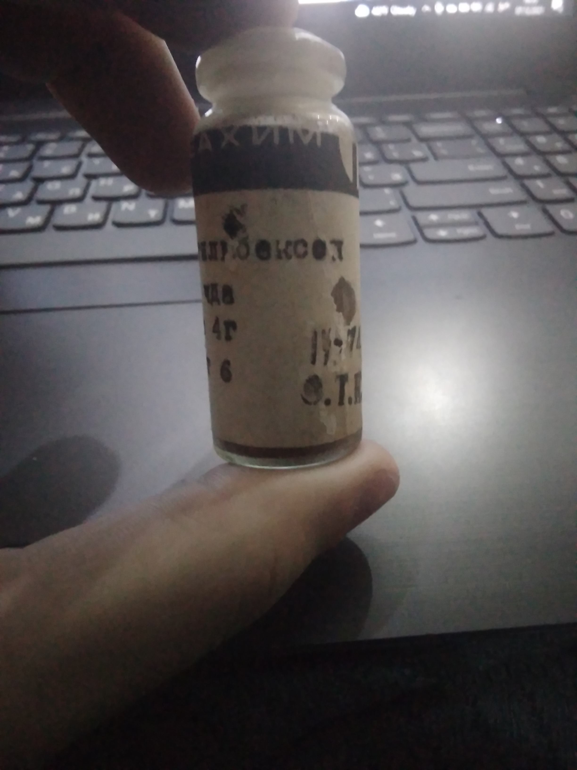

What is this?
PostPosted: 07 Dec 2021 20:04
Posts: 69131
There are no any photos.
PostPosted: 07 Dec 2021 20:21
Joined: 14 Jul 2021 12:13
Posts: 333
Location: Georgia
Maybe i accidentally deleted files.
PostPosted: 08 Dec 2021 10:28
Posts: 69131
Стильбексон - реагент для люминесцентного определения железа.

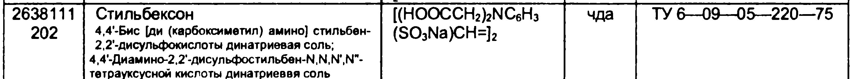

Нашел в каталоге совковых (советских) реактивов (по первым буквам названия):
Химические реактивы и высокочистые химические вещества. Каталог (05) Быковская А.С.,Светлов Д.В. viewtopic.php?p=154663#p154663

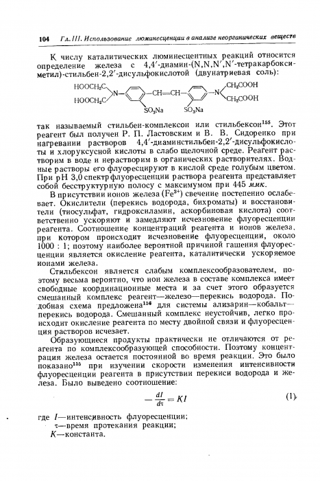

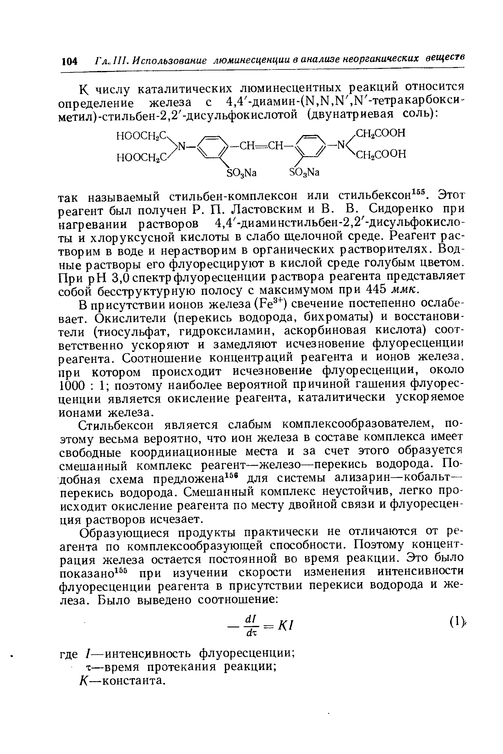

Описание применения стильбексона -
Божевольнов Е.А. - Люминесцентный анализ неорганических веществ

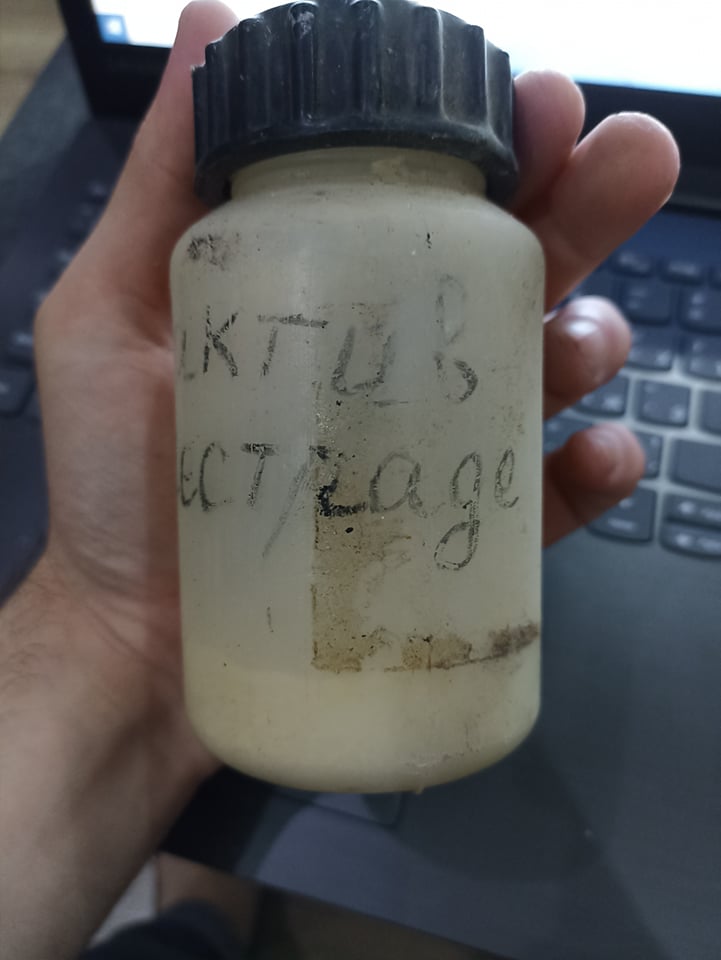

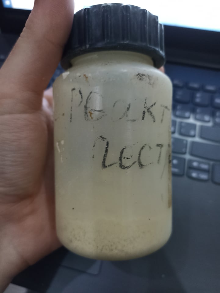

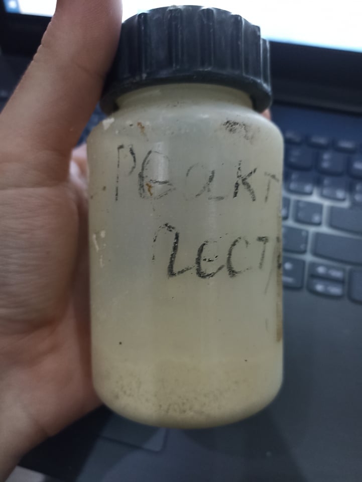

i can't understand what it is.
PostPosted: 12 Dec 2021 21:40
Lestrade's reagent. Used for qualitative detection of ketone bodies in urine (clinical biochemistry analysis). In the presence of ketone bodies, a color from pink to dark purple is obtained (the appearance of color can occur within 2 - 3 minutes). This is a microchemical test. All you need is 2-3 drops of urine and dry reagent in an amount about a match head.
Reagent composition:
Sodium nitroprusside (SNP) - 1.0 g
Ammonium sulfate - 20.0 g
Sodium carbonate anhydrous - 20.0 g
