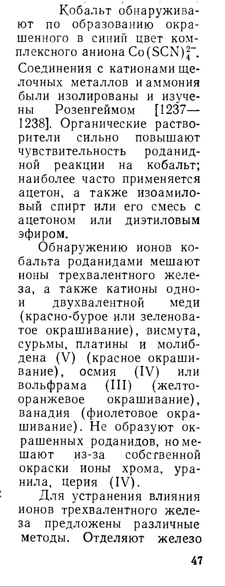

А никель как будет реагировать в этих условиях?
 Post subject: Re: Качественный анализ (качественные реакции, разделение...
PostPosted: 01 Jun 2023 17:23
Posts: 69388
Посмотрел монографию "Аналитическая химия кобальта" viewtopic.php?p=11899#p11899 - мешающих элементов для этой качественной реакции на небольшую поэму хватит, но никель среди них не числится. С помощью этой реакции даже можно открывать кобальт в солях никеля

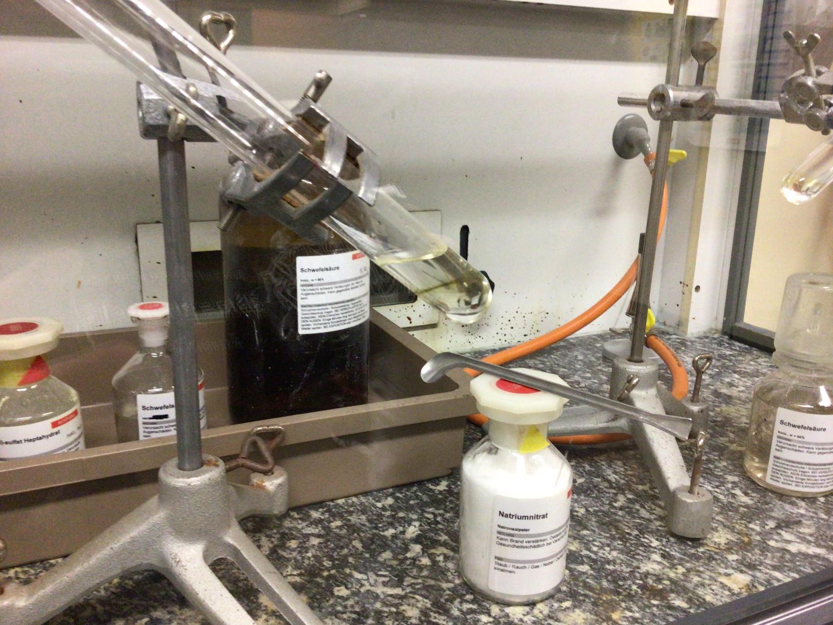

Brown Ring Test (qualitative nitrate test)
Brown Ring Test Procedure:
A common nitrate test is also known as the brown ring test. The experiment can be performed as follows:
Step 1: Take the solution of nitrate.
Step 2: Add iron(II) sulfate
Step 3: Slowly add concentrated sulphuric acid (H2SO4) such that the acid added forms a layer below the aqueous solution.
Result – A ring brown in color will be formed at the junction of the 2 layers. This indicates the presence of nitrate ion.
Brown Ring Test Reaction:
The overall reaction is given below:
Reduction of the nitrate ion, oxidation of iron(II) and reduction of nitric oxide.
2HNO3+ 3H2SO4 + 6FeSO4 —>> 3Fe2(SO4)3 + 2NO + 4H2O
(Remaining) [Fe(H2O)6]SO4 + NO = [Fe(H2O)5(NO)]SO4+ H2O
This test is quite sensitive till 2.5 micrograms and a concentration of one in twenty-five thousand parts.

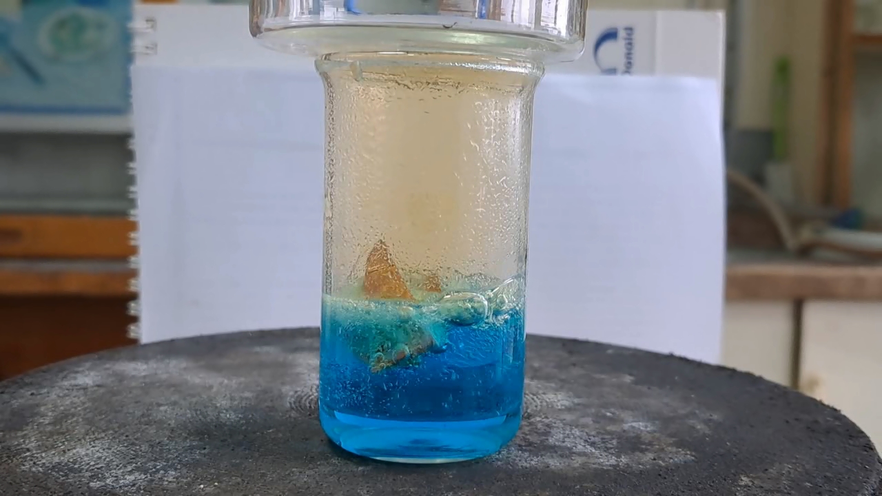

Experiments with Phenol
Phenol-Iron Complexes (Introduction) - Part 1
http://chemistry-chemists.com/N3_2025/C ... -P1-1.html

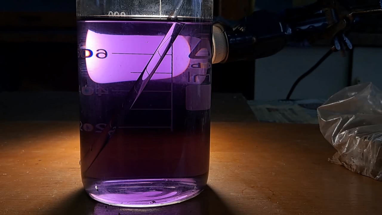

Phenol-Iron Complex and Sodium Hydroxide - Part 5
http://chemistry-chemists.com/N3_2025/C ... .html#1002
